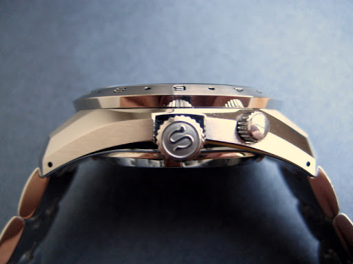

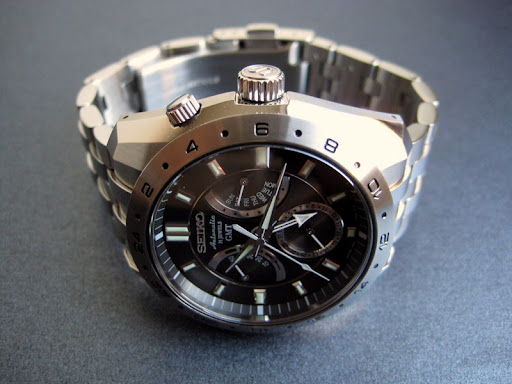

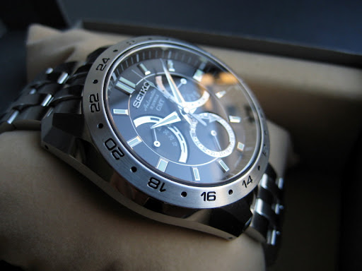

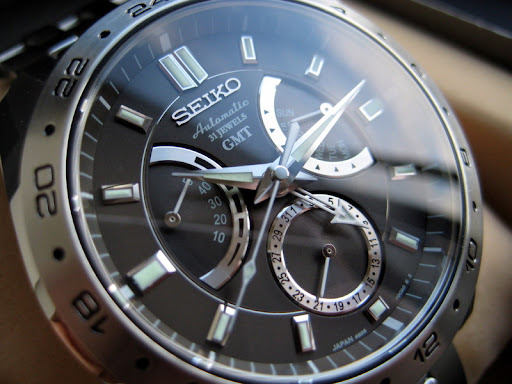

    This finally brings us to a recent acquisition: Seiko 4S36 Automatic GMT Retrograde (SARN001):
    Movement: Seiko Automatic Calibre 4S36, 31 Jewels, 28’800 A/hr, Integrated auto-winding, Micro-regulator, Diafix shock absorption, Thermo-compensating balance and hairspring, Auxiliary manual-winding, Hacking, GMT complications (independent), Date indicator, Retrograde Day, 50-hour power reserve with indicator, Accuracy range -10/+15 sec per day
    Case: Stainless steel (diameter: 40 mm excl. crown, thickness: 13 mm), 24 hour index bezel, screw-in exhibition case back, anti-magnetic
    Crystal: Sapphire Crystal, domed profile, with dual-antireflective coating
    Dial: Charcoal with LumiBrite indices and polished steel hands
    Bracelet: Stainless steel with push-release clasp
    Weight: 168g
    Manufactured: By Shizukuishi Watch Studio, Japan (for Japan domestic market only)
    MSRP: 262,500 JPY
    Despite the difference in external design, Credor 4S76 Node Retrograde (on the left) shares identical technical specifications for the movement as the Seiko 4S36 GMT Retrograde (on the right).
    Note the 4S trademark twin cap jewels and microregulator. Colimaconnee décor on the rotor is a Seiko tradition.

    One thing that divides opinions is the dial. Upon seeing catalogue pictures of the 4S36 GMT, some have commented on the busyness of the dial, and I do not disagree. However, high complications timepieces rarely have the luxury of at-a-glance simplicity.
    While the Seiko literature describes the theme as that of symmetry, I wonder if whether symmetry is the right word. Sure, in static snapshot, the dial elements can be seen as having almost mirror image symmetry, but a watch dial is hardly static when functioning,
    and even less so in a multi-complications dial with Retrograde, where hands traverse different corners the dial, in sometimes opposing directions. Static symmetry becomes dynamic asymmetry, creating irregularity in form, yet still balanced in composition. It is this asymmetrical balance that it referred to in Zen aesthetics principles as Fukinsei.

    Notice in all three, Seiko used a complex geometric arrangement of flat surfaces—matte and reflective—that have a slight one-way curvature. The case looks sculptured, chiselled, yet at the same time, the soft profile conveys gentleness and subtlety. It’s a great composition that achieves both modernism and classic undertones, and conveys strength in gentleness.
    We see how Seiko has evolved this duality in the Marinemaster Automatic Professional 300m (SBDX001), as well as the Marinemaster Professional 600m Spring Drive (SBDB001)
    (Image source: Adrianto, 20S)
    (Image source: Watch-Tanaka)
    The case lines have now become wonderfully sharp and complex, with a mix of convex and concave surfaces. The sculptured fluidity now characterizes the case of many high-grade Seiko, not only in the Marinemaster, but also in many Grand Seiko (GS).
    In the 4S36, the designers added further definition to the case lineage, this time by utilizing Sallaz polishing, a technique employed by watch artisans to achieve unparalleled level of beauty and brilliance of the mirror finish. The technique requires an extremely high-level of skill in manipulating the tool in smooth unbroken strokes, and is thus labour-intensive and time-consuming. This type of case finishing can be found among GS watches.
    The design of the fixed 24-hr bezel on the SARN001...
