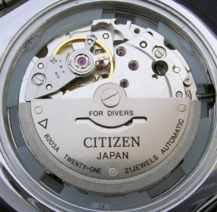

    Like many of you, I’ve owned many Seiko divers powered by the ubiquitous Cal. 7S26. A 4th generation of the long-serving 70xx family of calibers with roots going back to 1969. The 7S26, though, is a modern movement introduced in 1995 that takes advantage of modern material as well as the economy of automated manufacturing. The caliber is renown for robustness, reliability and durability.
    Citizen’s movement manufacturing arm, Miyota, has been equally busy since the 1970s, and the Miyota 8200 family of movement has been its bread-and-butter caliber in its ongoing rivalry with Seiko’s 61xx, 63xx, and many incarnations of the 70xx. As well as equipping its own Citizen automatic watch, Miyota also sells its movements to companies like Invicta, and pretty much anyone who wants them. As a result, Citizen became the world’s largest manufacturer of mechanical movement (though, I’m not sure if Seiko has now over taken Citizen). This is despite the fact that Citizen seem not to be investing much effort into further developing its mechanical movement, and prefer, instead to concentrate on quartz and Eco-Drive endeavors, much to the disappointment of die-hard mechanical WIS.
    Coming back to the Promaster NY0054, the diver is powered by Miyota Cal. 8203A, which is now into its 35th year of service. As I’m not about to crack open a new watch, here’s a photo of the movement of an earlier Citizen diver’s 8203A. It’s possible that the actual movement of my watch may look slightly different to this, though the workings are essentially the same. I mention this as the AutoZilla is powered by Miyota 8203B (pictured below).
    (Image Source: A_Junnghannz, Uhr Forum)
    As far as I know, the only difference is that the Cal. 8203B is better decorated, and possibly better adjusted. I may be due to the fact that the Cal. 8203 was used in the AutoZilla that many believe it to be the top execution of the 8200, and of a higher specifications than, say a Cal. 8215 that Miyota sells to Invicta.
    Regardless of the execution, the Miyota 8203, like the Seiko 7S26, is one of the simplest automatic movements around. Its design is devoid of excess, and in that sense, very pure and straight forward. Both the calibers contain 21 jewels and beat at 21,600 A/h with similar power reserve, but that’s where the similarity ends. The 7S26 features bi-directional winding, while the 8203’s ball-bearing rotor only winds in one direction (and this can be heard as you lift the watch up to your ear, and the rotor falls in the non-winding direction). To make up for this, the Miyota can be manually wound, while the Seiko cannot. This is useful if you happen to wear the watch occasionally, and need to restart the movement before setting the time. Neither movement feature hacking.
    It seems to be the general consensus that Citizen automatic watches are normally factory-adjusted to greater accuracy than the 7S26 watches. This is my first Citizen automatic (and only my second ever Citizen watch), so I’ll need to go on others’ experience. In this respect, I’ve also come across testimony from watchmakers who have serviced both Miyota 82xx and Seiko 7S26 (as well as Orient Cal. 46 which shares the same 70xx legacy), and they seem to agree that the general pattern is that 82xx wear less in the crucial areas of the movement, compared to the 7S26 and the Orient. Their conclusion is that the Miyota is more durable of the three. This has been reaffirmed by my own watchmaker, a veteran of Citizen for many years.
    All this of course, does not explain what I have here. A daily rate of +0.6 sec/day over 21 days is not just phenomenal, but the best ever achieved by any mechanical watch I have own to date. Here are the timing results.

    Nothing in its specifications seems to point to this. Simply put, this watch does not deserve to be this accurate. Considering that closest the other watches I currently own have come to this level of accuracy is -1 sec/day and, on the other side, +5 sec/day. The watches that posted these figures deserve to attain such greatness. One is a COSC certified chronometer—a 30 jewel ETA 2895, beating at 28’800 A/hr, based on the Tracteur ETA 2892. The other is a high-end Seiko Cal. 6138, 23 jewels, which came from the same family of movement that went on to become the Grand Seiko 6185 VFA, -2/+2 sec per day. So, for both to be beaten by a common garden variety workhorse Miyota is definitely not their proudest moment.
    In the end, I cannot really take into account the accuracy I have observed, and put it all down to luck. Still, I would still personally rate the Miyota 82
    03 slightly above the Seiko Cal. 7S26.
    MOVEMENT
    Citizen Miyota 8203A :thumbup: :thumbup: :thumbup:
    Seiko 7S26.............:thumbup: :thumbup:
